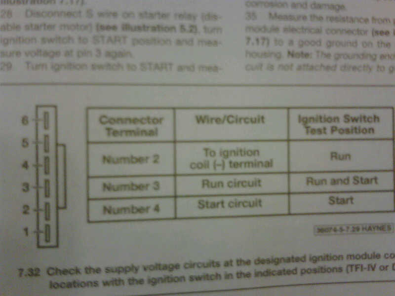

this is kind of universal but will help to test the PIP and TFI if it is distributor mounted.
Originally Posted by theramsey3 View Post
Bear with me my typing skills suck!
distributor mount TFI module test
to test the coil get out the DMM test the primary circuit for resistance it should be .3-1 ohms test the secondary circuit from the coil negative to the plug wire output resistance should be 8,000 to 11,500 ohms
Test for power at the coil with the key in the run position. Test ignition module output with a test light put the test light between the two wires at the coil harness if it flashes TFI module and PIP are functioning.
Coil primary circuit(see the below picture for TFI module pin out)
to test the coil primary circuit you should have already tested for 12v+ from coil to ground with key in run position now you need to test from TFI pin 2 to coil negative with harnesses disconnected resistance should be less than 5 ohms
next test from coil negative with only the coil harness disconnected to ground should be more than 10,000 ohms.

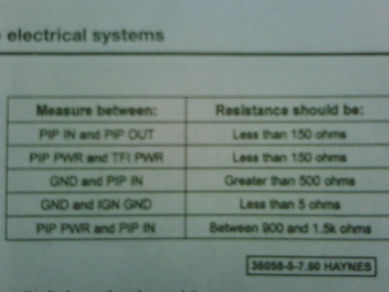

test power supply to the TFI module by using the chart in
PIP test distributor mounted TFI only

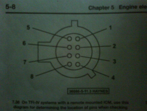

PIP test remote mount TFI only
remote mount module distributor harness
disconnect the distributor harness and test for 12v+ at pin 8 with the key in the run position now disconnect the S terminal at the starter solenoid/relay to disable the starter and turn key to start position test for voltage again. Hook the S terminal back up to the starter solenoid/relay test for AC voltage from pin 1 of the distributor to the negative BATTERY terminal by cranking engine. AC voltage should be between 3-8.5
measure from module pin 6 to distributor pin 1 resistance should be less than 5 ohms and finally measure from pin 6 of the remote TFI module to ground you should get more than 10,000 ohms.
