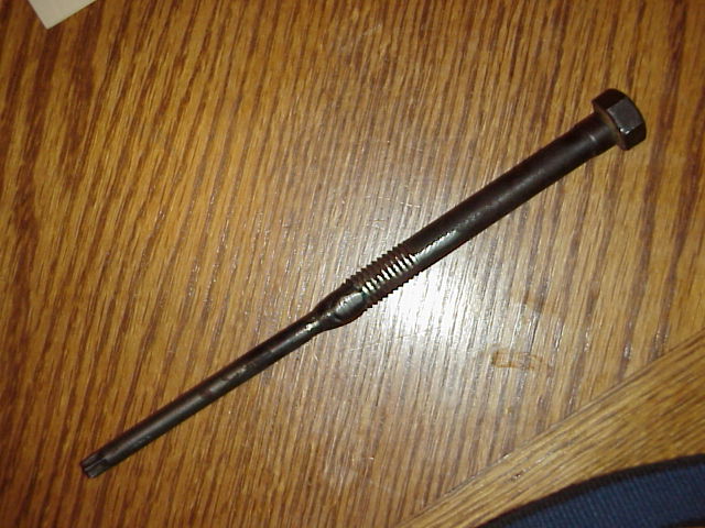

If it's the factory 5.8L manifold, THIS is the best tool:
Can you tell I hate the factory manifold setup?

post #9 of 19 (permalink) Old 05-27-2014, 08:30 PM
Join Date: Sep 2013
Location: Mufreesboro Tn
Posts: 85
Bronco Info: 1988 Eddie Bauer 302
Sarcasm? I'm contemplating using a hammer right now

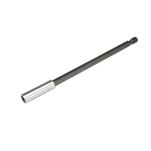

I use a magnetic screwdriver extension and a 1/4" Torx Bit
jowens1126 is offline

SuperMotors - Since 2002
BikerPepe` is offline
post #13 of 19 (permalink) Old 05-28-2014, 05:32 AM
Tiko433's Avatar
Join Date: Mar 2014
Location: Va
Posts: 103
Bronco Info: 88 XLT 3in body lift , 33s
Thumbs up
I went with 1/4 drive set up but taped it to keep it together. Hey Bikerpepe you should sell those on EBay

Harley's & Bronco's FTW!
BikerPepe`'s Avatar
Location: N.E. WA
Posts: 32,969
purely a one-off.

Bronco Info: '88 5.0L EFI, Stage 2 AOD, Yukon 4:88 grs (Locker (R), LSD (F)), 3" BL
GHETTO STYLE!
Nice! lol
I have one of those 3/8"-drive sockets with the T40 bit permanently set inside of it. I put it to my bench grinder and ground-down the socket until it was skinny enough to fit in the upper plenum's channel.
