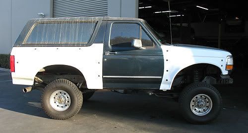

Well since steve and a few others asked my to start my own thread here it is. Here are most of the older pics and new ones from this weekend. I also posted updated in this thread before starting this.
Build a Daily Driver/Prerunner on a Budget
Made a ton of progress on the Bronco over the weekend. It got the nick name grave digger since it's sitting a little tall right now ... haha Gonna change out the front coils and have Deaver de-arch the rears. I want the thing to sit low and wide. I still have quite a few things to do to it in the next couple of days and weeks. Had to get it driveable since I sold my 06 F150 to Drew at the shop.
Here are the specs and what I did so far .....
Rear Suspension:
Deaver F53 F-150 rear leaf springs (made spacers to go from 3" wide Bronco springs to 2.5")
Camburg F-150 MIG shackles
Bilstein 7100 remote 12" short body shocks in stock mounts
Front Suspension:
Camburg 4" extended & trussed 4wd housings with steering extensions
Camburg heim 4wd radius arms
4" coil springs
S/S brake lines
alignment cams
new upper & lower balljoints
Still got to finish up the front and get the Bilstein 7100's mounted up. I'm running duals up front. Also got to get 5/8" wheel studs on the truck so I can mount up my 37" rims & tires. The stock studs are 1" long and my wheels are 1" thick. I put about 35 hours worth of work into it after work fri-sun. I'll post more pics as I make progress.

Looking good Scott! I thought for sure you'd go with a coil-over. Any plans to upgrade?

is there a reason i've seen several people now running f150 springs vs bronco springs?
nice welds
Andy351 is offline
nice welds
I concur on the welds.
I understand the F150 springs are "flexier" than the Bronco springs.
loook forward to seeing the front suspension photos...since thats what I'm working on now.
nice welds
You get more travel from the 2.5 spring. Allthough i'm pretty happy with my 3.0's.

The wider spring resists sway better.

They do get more travel , but a big factor for me was that Deaver dosent make the 3 inch lift bronco spring anymore,only the 6. And I stopped using National Spring after they changed owners a few times and started selling fabtech and rancho stuff. You can also run uniballs in the 2.5" springs too. We will see how long they last. Steve is right about the sway, but its not to bad. Oh Scott, before you have those re-arched fill the tank,throw in a spare tire, and take those wedge blocks out. Just move the rearend pads for pinion angle cause those cast pads shear the lineup pin sometimes, plus it will be an inch lower. Should sit perfect.

Steve ... I plan on setting it up for coilovers down the road once I cage it. Until then I'll run the Bilstein 7100's. Shane @ Bilstein set me up with some custom valving so it should work pretty good.
Mark ... thanks for the heads up. I'll hold off until I get the full floater rear end in and lose those pinion blocks. You have my steering ready yet? :)
Here are a few pics I snapped today when I was installing new front calipers. Should get the different front coils in the next day or two and then I'll mount up the front shocks.
The rear of the Bronco feels completely different, so far I'm really happy with it. It actually moves up and down now !!
It's still a work in progress. Jason here came up with some ideas for front hubs so you might see something pretty trick. He did something similar for his explorer he built.
...... and yes I know it's dirty and needs to be washed ... haha

Did you do the tubular frame for the front fender mounting or ?
And looks very nice by the way

I'm gonna pull the tranny soon and have Steve Culhane build it up, I already have a winters gate shifter for it, put a full floater rear end with 5.13 gears, I have AutoFab motor mounts I still need to install, want to build a center console for race radios, GPS, etc and then mount 4 race seats in it, build front & rear bumpers, build a roof rack to hold a spare tire, jack, cooler and light rack above the windshield like our race truck, install motor stuff I already have, get it painted ..... the list goes on forever ... haha
GKR yea I built the core supports when I installed the front glass.
Thanks 4 the comments everyone. Its awesome to see it coming around.

A real quick newb question... how do you get the metal to change colors like that? I know the welding will make it change a little, but is it just because the welds are so good? also, do you paint over those? I think the beams look look awesome.

The colors you see are the heat marks from the MIG welding. You can tell it's not a cold weld that way or triggered. That's what gives it that awesome look. Id like to keep them raw but they will rust quick down here by the beach.
