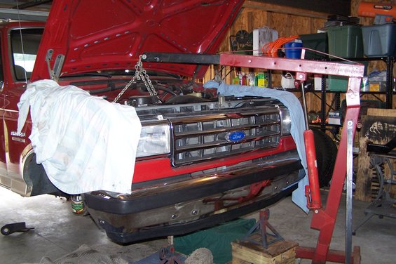

Finally getting pictures to everyone. Since finishing the SAS on my 2000 F150 my son wanted to do his 90 Bronco. As you watch our project remember this will only be a street and beach truck.
Thanks, John & John Jr.

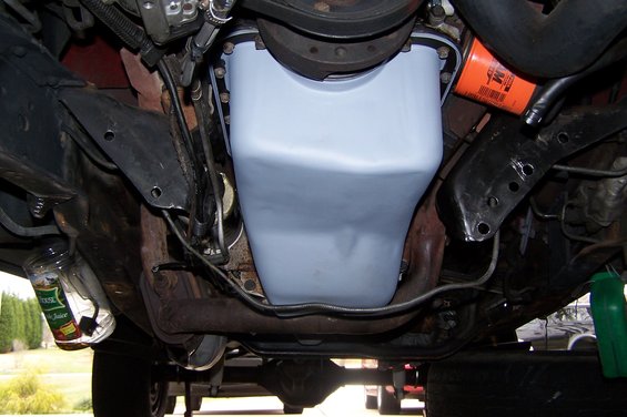

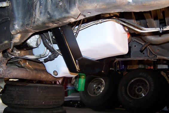

New oil pan gasket and oil pump installed

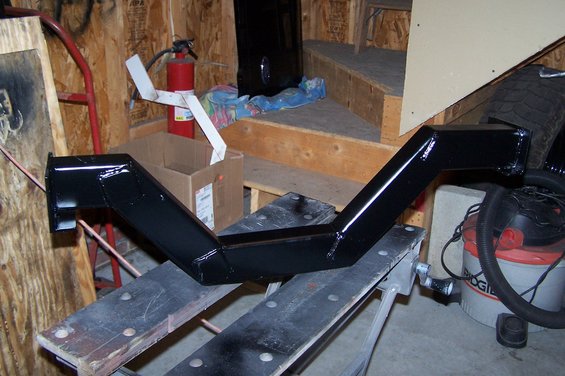

New engine crossmember, thanks for the help GKR.

Interesting. You planning on going with a low lift sas? If not why rebuild the cross member.

Reason for removing the orginal crossmember was to make access to the oil pan, since we had to replace the gasket. A lot of work to remove the orginal crossmember but still less work then trying to remove the pan with the member in.

I really like the cross member. When i did mine i hated the bulky stock one
Thanks. We hated it also. I'll have updated pictures Monday, Spring Buckets modified and installed, shocks installed, brakes installed, etc.
